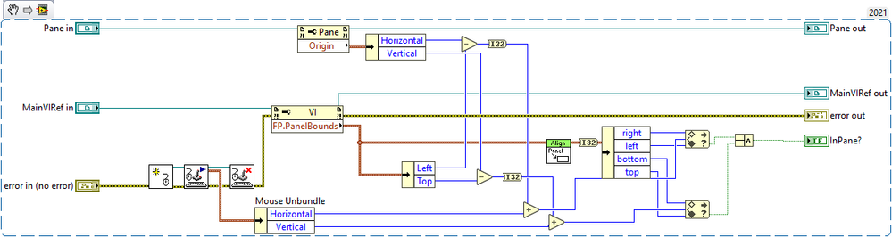

UI mouse enter/mouse leave has some subtleties, not sure what is going on in your case as I cannot see the code, but here is one as I remember it.
  1. There can be Mouse Leave Pane events without the mouse ever moving out of the pane. For example, dismissing a right-click menu event triggers a mouse leave event even though the cursor might still be in the proper pane. This can throw off the entire sequence.
The solution that I pursued was looking at the mouse coordinates for a Mouse Leave event. If they were still in the pane, ignore it, if not then do my case.
My UI issue was somewhat similar to yours. I had a transparent File Control on top of a Table; the user could drag and drop a file on the control to load values. Similar to you, both the table and File Control filled the whole pane.
The Code below uses the LAVAG UI tools, but will tell you whether the mouse left the pane or not. Not sure how it will work if you use scroll bars for your pane, origin is not right, etc.
