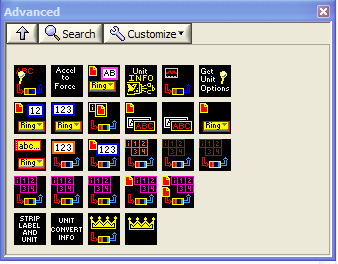

Here are the icons that I use for my MS Excel llb. (for those of us that do not get the money to get all of the cool tool kits).
22949iFBF720935D3E7149
I think these are very useful and intutive
Here is a different LLB for unit conversion where only the polymorphic VI's get the nice front end and the subs do not.
22951iB0A7A193C81C1FBB

22953iB911D194FF6711EC
