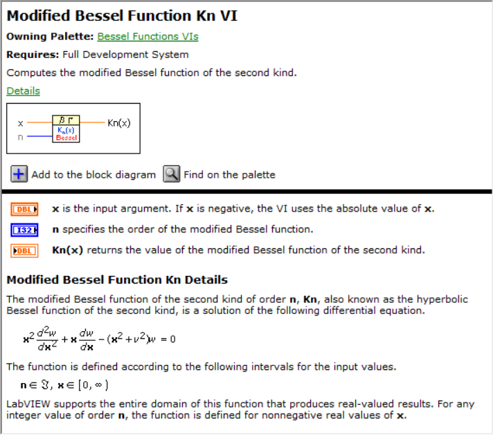

Is this what you are looking for?
It is on the Mathematics Palette, Elementary and Special Functions, Bessel Functions sub-Palette.  Note that you need the Full or Professional version of LabVIEW.
