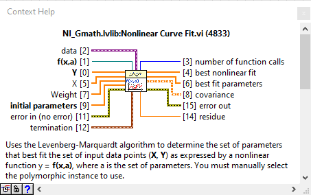

Well, I was able to partly "see" the code in your picture, and can make some comments about the "broken wire".  If you read the Help for the Levenberg-Marquardt algorithm, you'll see that it requires a function in the "f(x,a)" input.
The Help gives you a Template for creating this function, where X are your Array of input data (X), a is the Bessel "order" (0), and f(x,a) is the Bessel function you are fitting.
It has been a few decades since I used Levenberg-Marquardt, but my Forum colleague @altenbach is definitely "up-to-date" on this algorithm, especially the LabVIEW implementation, but I encourage you to use the Help, write the appropriate Fitting Function, and pass its reference (do you know how to get a reference to the function?) to the f(x,a) (the bold letters on the Help means this is a required) input to the L-M function.

     I was busy replying to your previous post and didn't see (until now) that you posted your code.  Thanks, among other things, it tells me which version of LabVIEW you are using.  You definitely want to look at the Examples listed at the end of the Help.  Note that they involve a separate "Model" VI that takes as inputs your model parameters (a, b, and c) and a sample value (x) and outputs a*Kn(x/b)+c, the model output whose fit to the data you are trying to optimize.  Once you've made a VI with your Model (I strongly recommend making a VI Icon for this Model, if nothing else saying "Bessel K0"), you'll need to go to the Application Control Palette, drop a Static VI Reference (which will have a big Question Mark in it), right-click it and choose "Browse for Path" (you need to have saved your Model, "Bessel K0 Model.vi"), right-click again and choose "Strictly-Typed VI Reference" (which puts a red Star on your Static VI Reference, meaning that it will "carry the Input and Output Types of the VI in the wire).  When you're done, you should have something more like this (which I haven't tested, as I wouldn't be sure what I was looking at, and thought you should have the experience of "seeing it first") ...

Hi Bob,
Thanks a million for your time and kind help!!!!!
It works.
Best,
Wen
