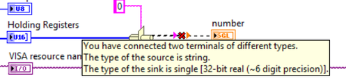

I can read values from the Input register now. I get for example, temperature (float, two spots in the register) value 16872 and 0 (engineering units). How do I convert this to Celsius?
This is a dynamic variable, and I would like to save some values into a file. Do I use the "Write to Measurement file" inside the loop?
Message 7 of 30
(5,462 Views)
Typecast to a single precision floating point number.

My "Single precision float" seems to be different from the typecast output. Pink vs orange? 😐
A couple of values have two register addresses next to each other in the read register (due to float?). For example "Temperature (Secondary Value), degrees C, register 1010-1011".. Does these  values have to be merged before the type casting? Or how does that work? And if I want to read values from different addresses, with different units - how do I handle that?
