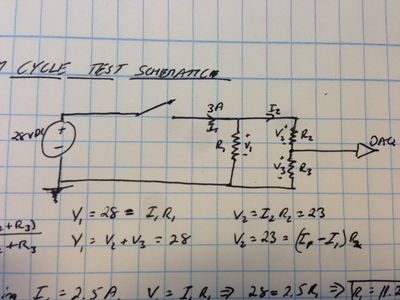

To ensure a 3A current at each switch, you can build a "Current Source" or "Current Sink" circuit (schematics are easy to find online).  Note that in reality, resistor & transistor values vary from part to part so each circuit you build will not be identical (something you may need to consider).  As far as measurement, you could build a voltage divider circuit to measure the voltage drop across a reference resistor.  If you are truly only interested in determining the end of switching, choose your resistors so the voltage drop is in the 4-5V range and wire this to a 5V TTL input (this range will be considered HIGH).  If you want analog measurements, you will need to be careful to calibrate each circuit (since they'll each vary a little).
Remember that resistances change with temperature so make sure the circuit is what you want at the measurement conditions (use power resistors to reduce the heat generation from the 3A of current).

I was thinking of doing something like this.  V1 would be responsible for taking most of teh 3A, while the other two resistors would be the voltage divider.  V3 would be the one that provides 5V to the DAQ.
What would the advantage be of using the current sink, rather than what i've shown here?  Is there a better way of doing this?
The circuitry would not be exposed to temperature (kept outside of the chamber)
All options welcome at this point.

switch bounce can be an issue with your counts....I would use a pair of SR nand latches attached to the throws with pullups (common tied to gnd). latch#1 set tied to latch#2 reset and latch#1 reset tied to latch#2 set.
