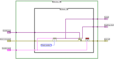

Inside the FGV the data is stored in a map where the key is the data name and the value is a variant. Other then this there is no relationship between the name and the type. Because the data is stored as a variant there is only one writing VI which is the "write anything". It takes the data name and any type of a data and adds it to the FGV without caring about the type of the data. And practically there is only one "Read data" VI which returns the variant part of the map based on the data name and that variant can be casted to whatever type. To make the programmers' life easier though, I created VI which wraps the "Read data" VI and takes care of converting the variant to the most common types. To give an example the screenshot below shows the "Read boolean" VI, which takes the data name, reads the data from the FGV and converts it to boolean.
Now it takes only a string, but would be nice to take enums as well.
As explained the wrappers can be set to malleable and then it takes strings and enums and nothing else which is great. I just lose the polymorphic ability which I liked a lot as I could change the poly selector based on the datatype I needed there were no need to manually place a different VI.

Could be, but I didnt find a way. If the datatype would be an input of this VI then sure, but it would be mega annoying if the programmer would need to connect a U8 constant to the input of the VI everytime he wants to get a U8, thats what the wrappers for.
(I already have a malleable VI called "Read.Anything.vim" for data we have no wrapper for (eg: any custom clusters). This VI requires the data type to be wired, which is good flexibility for custom datatypes.
This is the "Read.Anything.vim":
Sorry, can't post a source code.
