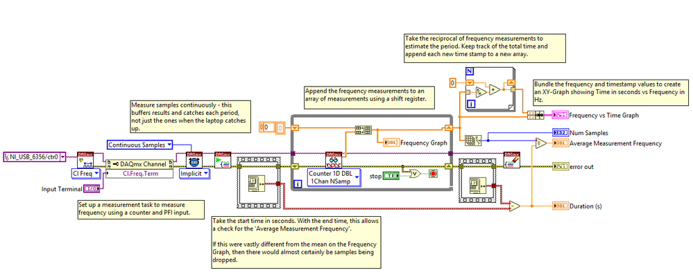

Some small modifications got me where I needed. An image of the VI and the VI are attached (although I moved to Freq rather than Pulse Freq, because for some reason I couldn't persuade DAQmx to accept a CI.PulseFreq.Input.Term (or whatever) input, and kept being told the property was not available...)

Ok. Sorry for gubbing up your post, but this problem does interest me. For your buffered counter, I think I've found an example that might interest you. Can you look at "Counter (Buffered) - Continuous Output.vi" Its within the example programs that ship with LabVIEW.
Thanks for the effort anyway! I took a look at the example you mentioned, and in the process saw "Counter - Read Pulse Width and Frequency (Continuous)" which does basically the same as what I posted already. Shame I didn't see it earlier!
