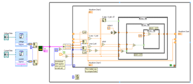

@ratsh wrote:
I have to develop a program to track the maximum power point of solar cell continuously, as i am new to Lab View its getting very hard for me to understand some terms. still i tried to develop some algorithm by looking some research paper, but i have some confusions related to case structures and also i don't know whether i am going in right path.
Can anybody give suggestion on this. It will be very helpful for me.
It would help to know what you are trying to do (e.g. "some algorithm by looking some research paper" needs some clarification).
"Some confusions related to case structures" could be clearer. What is your confusion?
Obviously, the code is broken, but it's hard to suggest the right solution if we don't know what the result should be. You should specify a value for the other case or right click the output tunnel to specify "use default". Which one is right? Who knows..

Hello

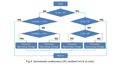

sorry for the not being clear, Actually i am trying to devlop a program using Incremental conductance method for MPPT tracking. I used reference from research paper but i am not sure with the case structures true block. And i need a power voltage curve in the end which can track Maximum power point.
I have attached a file, that is what actually i am trying to do.

But I see that the Keithley 2400 is a power source meter and not just a DMM. So you basically want to use it as your converter electronic load. That makes sense for a test setup. But with questions like "I'm not sure with the case structure true block needs to be" it's really hard to give any good advice. There are three case structures, all of them with empty true case. It really sounds like: "I have no clue and want someone to do this for me".
Looking at your code, all you are doing is to setup a sweep on the Power Source meter and then analyse its measurement results. That is not really MPPT. You simply could multiply the voltage and current of those measurements and simply use a Min/Max Array function to find the maximum value in that function and are done with it. No MPPT needed for such a setup.
What happens in the cases not shown:
Is in the flow chart:

 I tried getting an IV and PV curve, after that i developed algorithm using incremental conductance method. Now i want to give the output of this algorithm to update my old Vset so that i can perform mppt. can you please give any idea on this, how it can be done?
Thanks in advance
