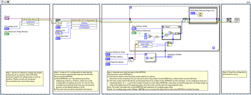

@GeneralDynamic wrote:
What do you mean the I2C example that ships with LabVIEW? How can I get this?
Go to Help, Find Examples.  In the "Search" option, type I2C.  Click on what it finds.  I've attached the 2019 845x "General I2C Write" VI as a Snippet -- it has no "hidden states", so you should be able to manually reproduce it.  I've never used I2C (but have used the SPI examples, and "think I understand SPI"), so I can't offer much additional help (like why there are references to EEPROMs).  Some of the other examples might be more appropriate.  I'll note that writing code for the SPI version of your chip was pretty straight-forward.
Message 17 of 21
(3,555 Views)
