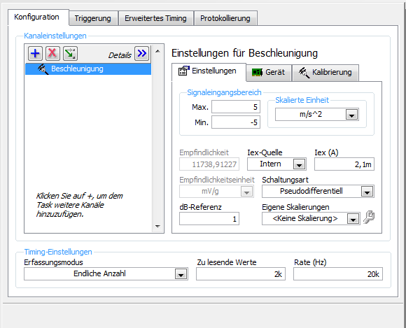

usually I do conversions in my own LabVIEW vis , however today I tried to create an acceleration task in MAX. DAQmx 18.0.0f0  (you can reproduce it with a simulated USB 4432 or so).
After creating the Task I was a little upset, because the sensitivity scaling doesn't support SI units, only something funny like mV/g or V/g ...   but offers the correct scaling units  m/s²
I haven't tested if a conversion to SI units will happen ... will it?
So no valid SI unit's are offered for the sensitivity!  (I think it will scale to g_n but not even the scaling factor is noted, or is it g_local ?? 😉  )

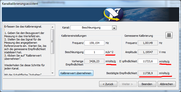

OK, lets do a calibration:
UUps  WTF   (I haven't supplied correct reading (SIM device) however what scaling is it??)
Spoiler
And you don't write mVolts/?,  it's mV/? ...   let's call it a typo 😉

and back at the task:
What will be the output??

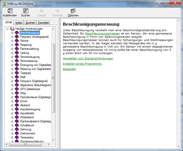

Finally, let's have a look at the Help link for acceleration:
Sorry, german, while I can install LabVIEW in englisch, I can't do it for MAX, DAQmx... would ease a lot
However I assume in all language versions the unit for acceleration is wrong. g is no unit, g_n is a value valid at less than 1% on earth.
I had customers asking if they should use g_local (they had measured) instead ...
If you want to process acceleration values you have to convert to SI units anyway.
So please fix the bug(s) and convert to SI unit.
Even if you change it now, the units will not change after 20. of Mai (start of the new SI) 😉
