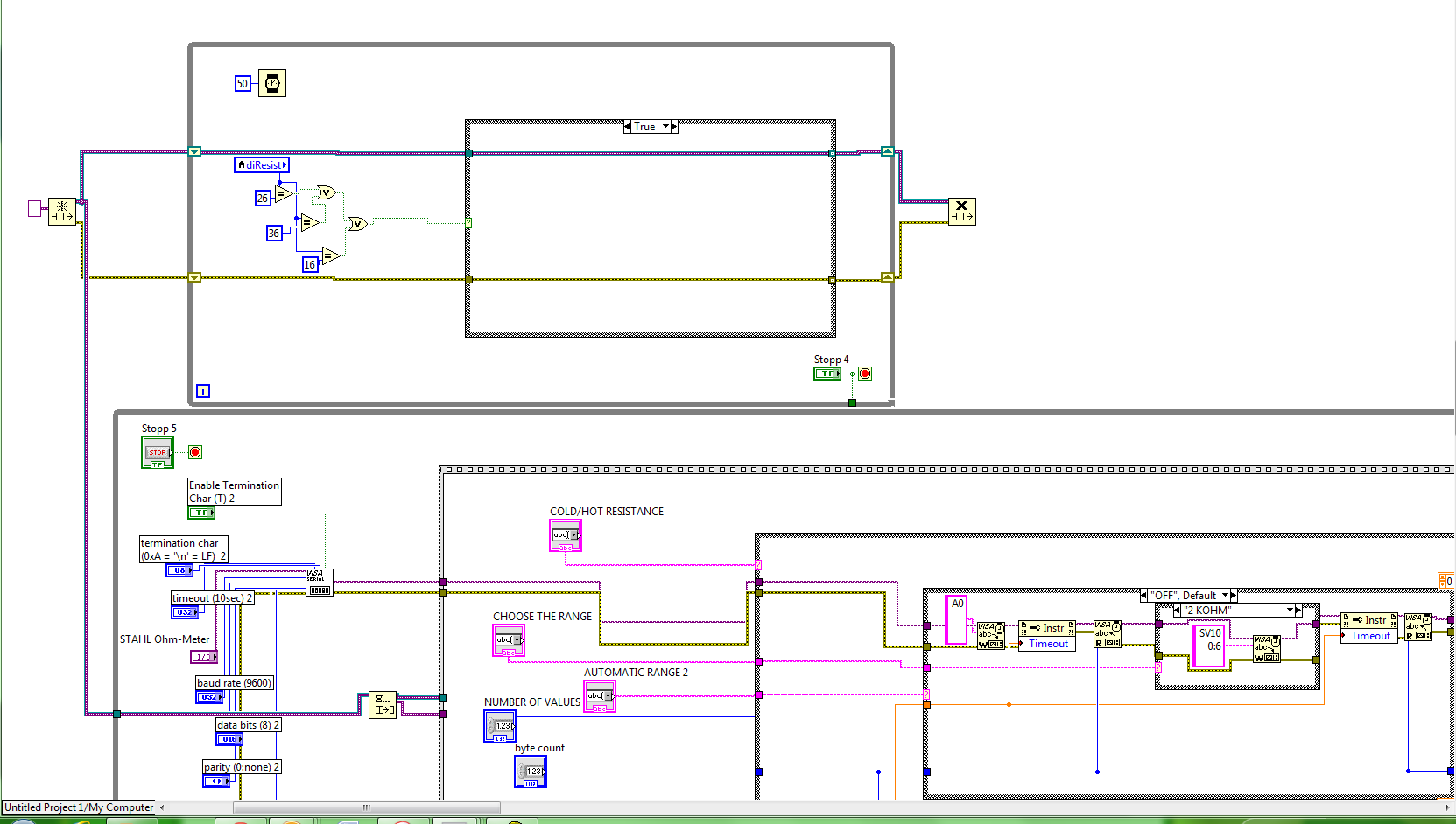

Hi,  I am working to calculate the internal resistance of a motor. My program is communicating via OPC servers to the PLC.
So what I actually need : When the state of the shared variable diresist is equal to 16 26 or 36... the program should run and make the whole sequence.
I tried with an event loop on the state of diresist but the program didnt run normally (you can only command the event structure from the front window)
So I tried with the while loop as in the program attached but I am getting the measurement in loop (he doesnt stop measuring). and if I click on the stop button, the program stops after making the measurement the second time. (Which is not a solution because I need the values and the graph of the first loop)
Any ideas please?

What does "diresist" mean?
Your diresist is not a shared variable.  It is a front panel indicator.  Also, since it is an indicator and not a control, there is no way to change it while the program is running.  It is also why the event structure would not act on it.
Your stop button gets read once per loop iteration.  It probably gets read very early in the loop iteration since the reading of that terminal is not dependent on anything else.  That is why it appears your loop runs twice when you hit the stop button.  Because it doesn't get read again until the next iteration.

You CAN trigger an event structure programatically by using the property node value(signaling), just make sure you don't program an endless chain of events. An easier approach would be using a notifier/queue via a producer/consumer loop, where one loop is querying the shared variable at a reasonable rate (maybe 10 times a second, depends on your needs) and sends a notifier or queue element to consumer when it reaches the desired value. Something along the lines of this

Thanks for the answer..
No it's not working actually.. this is how I made and I am not getting any results..
Message 8 of 37
(7,729 Views)
How should we debug a picture?

Did you go through the link?
-Simply adding queue doesn't solve.
-what's the datatype of queue?
-In first loop,inside true case if you are not doing anything how do you expect something to work?
