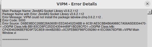

When I tried to install this .VIP file through VIPM (run VIPM using "sudo ./vipm" on a terminal, then after VIPM opens, click "Open package file(s)" and select the .VIP file), it shows that it was able to be found:
Then I selected "Add to Library & Install", at first it seems that it was added to the library because it passed that step, even though I didn't see this package in the library. Then I selected "Yes" to accept the license agreement and start the installation, but an error message popped up saying "VIPM could not install the package ...":
Here's the error details (error code: 5000):
Is this caused by LabVIEW Linux version? Or VIPM? Or the ZeroMQ package? Or some wrong setting?

VIPM is up today, because there's no error on accessing the package repositories any more.
However, the problem I encountered before still exists. When I tried to install the .VIP file for ZeroMQ, it showed that "VIPM could not install the package labview-zmq-3.6.2.112.", with error code 5000.

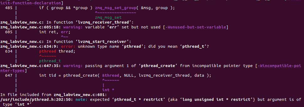

Thank you very much for the suggestion. I tried the manual installation. All steps worked until the last step: I was able to copy all the files in vi.lib, the examples, and the palette, and they all showed up in LabVIEW. And I was able to compile two .c codes to .so files (bonzai.c and debug.c), but there's an error when I tried to compile the final C code ("zmq_labview.c").
Here's the error message:
Apparently, the problem is: it cannot find "extcode.h" , which is related to memory operation. I downloaded this file from github cintools and copied it to the zmq library folder (same as those C codes), but it didn't work. Any suggestion? Thanks!

Thank you very much for the prompt response. I located the extcode.h file and added the full path to the C code. I was able to get pass this stage.
Then there's a new error and a bunch or warnings during the compilation. Here's the error, which is related to pthread:
I then added the full path to #include </usr/include/pthread.h>, but the error is still there. Is there any issue with the C code (esp. line 634)? Here is the part related to pthread:
Thanks again for your help.

Finally got it working.
Here are several actions that I took to fix those issues (I don't know whether they are all necessary):
1. Changed Line 634 of the zmq_labview.c code from "pthread thread;" to "pthread_t thread".
2. Updated the LabVIEW version in the "makefile" file to 2024, 64 bit.
3. Since I'm using 64 bit OS, I changed the handle "m32" to "m64".
4. There's an error showing that "libc-header-start.h" is missing, which seems to be related to 64 bit OS (the default is 32 bit), so I used "sudo apt-get install gcc-multilib" to install the 64 bit library, which cleared the error.
5. Run "sudo make" to make the .SO file.
6. The "lvzmq32.so" file was generated automatically in the "vi.lib/addons/zeromq" folder. which didn't match the zmq_libpath.vi setting and caused another error. So I moved it to "vi.lib/addons/zeromq/lib".
