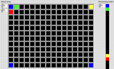

I want to process the array of an image lexicographically (meaning reading as you write, so from left to right). Normal arithmatic functions (division, multiplication etcetera) multiply the entire array, but I want to push the top-left pixel through my algorithm, and then the one to the right of that, and after that one the one to the right of that, up until the last pixel, and then it starts with the pixel one row beneath the first one all the way on the left.
 To illustrate, imagine an image of 12 X 16 pixels:

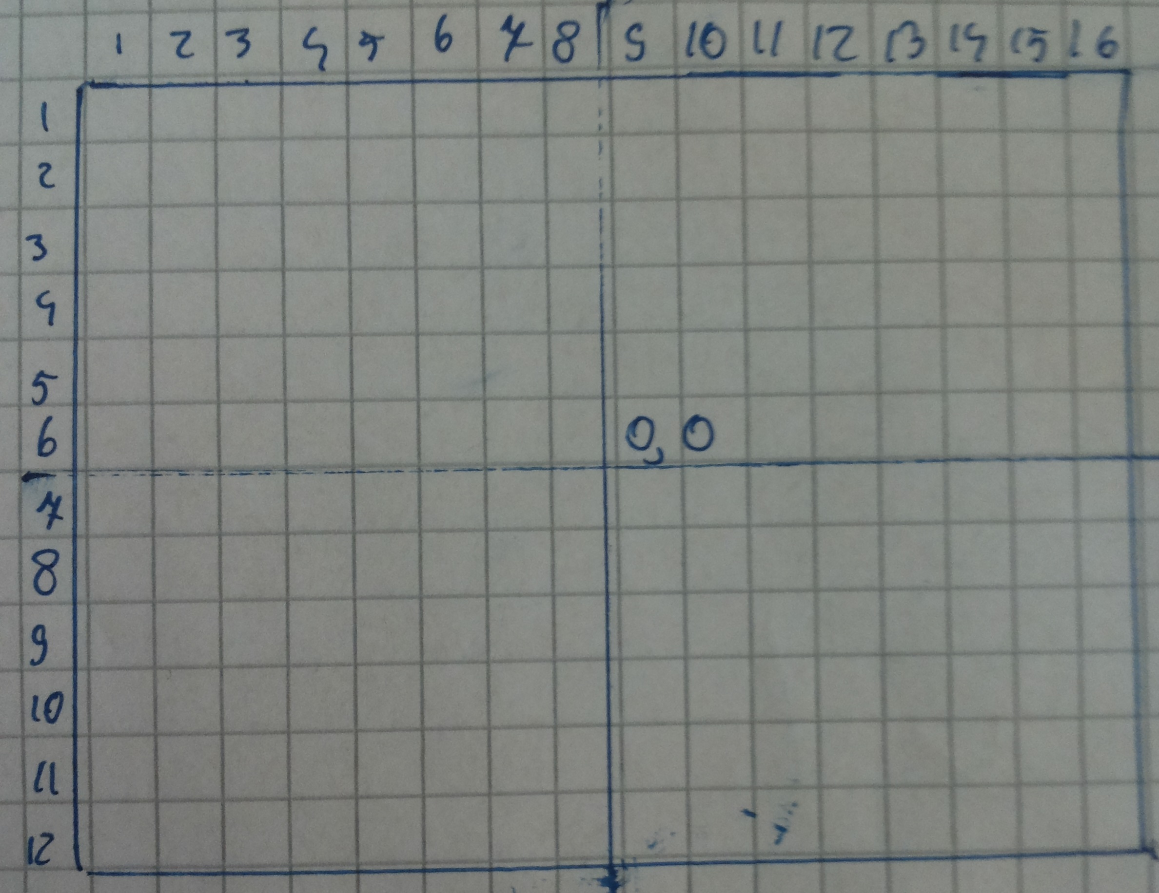

I want to calculate what value each pixel is supposed to have. I do this by comparing the actual value with the value I want. I calculate the value it needs to be at a certain pixel by looking at how far it is from the origin. The origin is in the center:
The distance then from the origin to the actual pixel is this:
The length of this 'vector' is then calculated by splitting it into a horizontal and vertical part:
The length is then the the x-coordinate squared and the y-coordinate squared added together and then the root of that number is taken. So that's basically the theorem of Pythagoras. I know that in this case, the length found is not the real length, because you use x=1 and y=1. So first off I subtract 8.5 from the x value and 6.5 from the y-value before going any further.
But I want to process the pixels in the order of y=1 x = 1, 2, 3, 4, 5, 6, 7, 8 etcetera and then y=2 x=1, 2, 3, 4, 5, 6, 7 etcetera. That is exactly what lexicographical processing is. But how can I get this to work? In my VI you can see how I am currently exporting just the numbers of the total size of the image (or frame of a video), but I want to process them one by one. I looked up some helpful Labview files that do something similar, like the 'Check Pixel Value' VI but there you have to manually scroll through the data. I want it to happen automatically.
So how can I process pixels of an image lexicographically?

Forgive me if I'm missing the obvious, but I read and re-read your post a few times and is the solution not as simple as:
When you have a 2D array and you have a nested for loop with indexing, it will iterate through the 2D array in left to right reading order. You can then either re-index the items to build another 2D array of calculated values or do what I've done and concatenate the second terminal to put the items into a 1D array.
I can't see your VIs as I don't have LV2013 but I'm assuming you have a 2D array of something and you want to process each item in lexigraphic order?

As shown in my beautiful drawings, I want to calculate the distance of the pixels, ofcourse in lexicographical order. Since you have shown me that the standard way for Labview to process arrays is lexicographically (and I must add I am very grateful for the insight you have given me) that is no longer an issue.
For the 'distance to center' calculation, I want to try the following:
Since I know it's going to calculate from left to right and starting in the top left corner and I know the resolution it will need, why not use that information to 'count down' from the resolution?
By that I mean the following:
I know the resolution 1024 x 768. That means the center is at 1024 / 2 =512. However, since it's an even number, there is no absolute center pixel. So the actual middle (or median) is at 512,5.
Same goes for 768: 768 / 2 = 384, median is at 384,5.
The center of the image is at 512,5 x 384,5. If you do not agree with calculation to find the middle of the image, then by all means please say so, for I myself cannot remove doubt from my mind even though I have the proof of it laid down before me in the form of a drawing.
But then the pixel at the top left corner is then at a distance of:
square root of (512,5² + 384,5²) = root of 410496.5 = 640.7000078. I then use that for my formula to calculate what value it should be (the superlorentzian formula). These coordinates will then also ofcourse work for the bottom right, bottem left and top right of the image, since these are at a distance that is the same size.
Then I perform the same calculation but then I take pixel next to it: it will be at a distance of which the horizontal and vertical components are also known.
The first pixel was at a distance of 512,5 horizontal and 384,5 vertical
The second pixel was at a distance of 511,5 and 384,5 vertical
The third was at a distance of 510,5 and 384,5 vertical
The fourth pixel is at a distance of 509,5 horizontal and 384,5 vertical
Etcetera
I am thus now 'counting down' from the known coordinates from the top-left all the way until -512,5 and 384,5 vertical.
When that point (the point -512,5 x 384,5) is reached I go down one part vertical. So I then use -512,5 horizontal and 383,5 vertical. That way I calculate down from 512,5 x 384,5 (top left corner) all the way until -512 horizontal and -384,5 vertical (bottom right corner).
This however is more of a 'brute force' method. Is this the most efficient way to do this? Or can Labview give me the values themselves without me having to presume their location (which is what I am basically doing right now).
