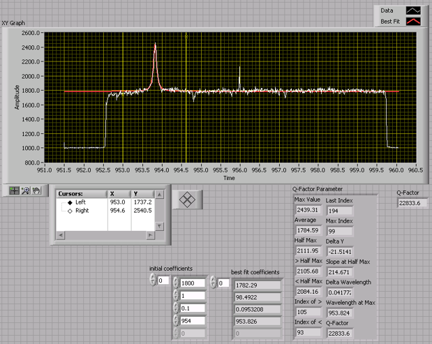

Hi guys: I've got a long story here. It all started when I was using Lev-Mar VI to make a Nonlinear Lorentzian fit. This fit however gives me a very strange error message: "LabVIEW: An exception occured within the external code called by a Call Library Function Node. This might have corrupted LabVIEW's memory. Save any work to a new location and restart LabVIEW.VI "test.vi" was stopped at node 0x0 of subVI "NI_AALPro.lvlib:Real SVD Decomposition.vi". Then, when I run it again, it gives me another error message saying: "Error - 20041 occurred at NI_Gmath.lvlib:Nonlinear Curve Fit LM.vi" "Possible reason(s): Analysis: The system of equations cannot be solved because the input matrix is singular." I've attached my program and the data with this message. Can someone please help me out. Thank you very much

The main problem is the fact that you are calling the "general Lorentzian" function, which expects 5 parameters and extra data, yet your initial estimates only contain 4 elements and you don't provide the extra data. At the moment you should call the plain "Lorentzian". It works well!
The more general problem is the fact that you do many things way too complicated. Virtually all of your loops have near equivalent built-in functions.
The code is completely fragmented and parts linked via local variables, while sequences are then used to re-establish execution order. You should also get rid of all stacked sequences and all these extra controls that have the sole purpose of providing local variables.
 (You seem to be coming from text based programming languages, so you should loose that kind of sequential thinking! The wire is the variable! See also this old post)
Once everything is wired together, data dependency will properly determine execution order and the sequences are unnecessary.
I cleaned up the code a bit, but please verify correct operation (you might need to tweak some edge effects here or there, nothing a +1 or -1 cannot fix, who knows? I literally translated some code segments because I wasn't sure what you were really trying to do). One glaring error was the fact that you indexed into the array subset as if you are still operating on the full array. I left a diagram comment. I am sure many more simplifications are possible.
I reduced the entire project to 4 relatively simple VIs. The main VI also shows the best fit function, overlayed over the data. See for yourself.
