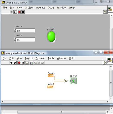

Less than operator misbehave
The values came from (string to number) pattern match and were misbehaving.
After tinkering with type casting and formats (didn't spend much time though), there was no change in wrong evaluation:

Sneaky. X is 4.4999999999999998
Richard

No it works. And this is common problem then working with floating point numbers :smileyvery-happy: The problem are caused by small rounding errors. The number format is the source of the trouble. It has been a lot of postings about this
Use the in range check instead.

Yes, correct.
but least expected this. as it was initialised as fig.1 and incremented as fig.2

labview-programmer wrote:
Yes, correct.
Aniket, change 'em to DBL's.
