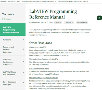

Hi Thols,
I still only work with (older) LabVIEW version including their offline help…
Right now I opened LV2016:
When I opened the online LabVIEW UserManual I just found a link to the LabVIEW Wiki StyleGuide on the very first page:
I seems my recommendation to "read the help" isn't as valid as it was years ago…

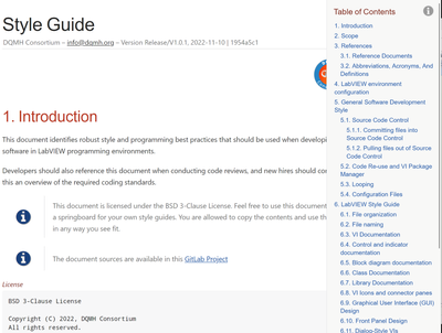

Hi
Documents related to 'development', 'style', 'checklist', or 'guidelines' has been hosted in various locations over time.
NI created a 97 page PDF file, with the latest from 2003 as part of the 'LabVIEW BookShelf for version 7.0' ( google for document 321393D-01 ).
Chapter 6 was the 'LabVIEW Style Guide' described over 22 pages :
Since then 'style' has been part of the help system embedded in the CHM file lvdevconcepts.chm included in every version of LabVIEW and automatically opened by LabVIEW Help :
The content of that file was pretty much unchanged until 2022.
2022 Q3 saw the introduction of the replacement for CHM file(s), giving the new help viewer. Pretty helpless :
Since release 2025 Q1 the 'style' content has moved to 'LabVIEW Wiki'. Which is not the same as the online or offline help. Maybe to encourage contributions to keep the content up-to-date :
DQMH Consortium released 'The Style Guide' in 2022 :
Hope this overview clears the waters a little.
