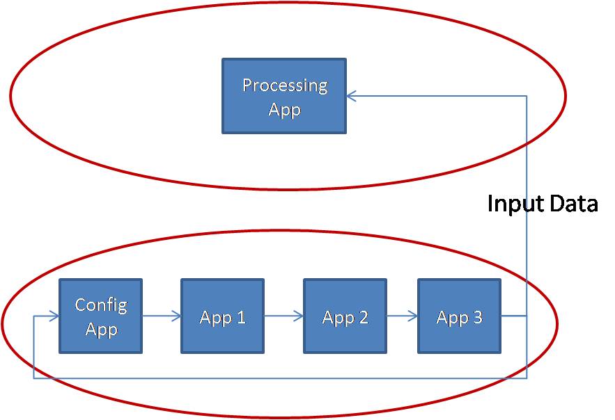

Hi all,
I am thinking about the structure of a large application.  I have built 5 independent VIs (each from independent LV Projects); 4 which gain the necessary inputs from the user (each has While Loop with Event Structure) and do their own processing to devise a large set of input data and parameters for a main processing VI.  The main processing VI can be slow to function.
I was considering the following structure:
A main UI VI which calls each of the 4 UI VIs in succession using an invoke node or similar via the VI subpanels.  I have never used a VI subpanel.
Passed to each of the 4 UI VIs is a large cluster which each contributes to.
The large cluster is passed to the main processing VI (which has independent While Loop) via a Queue?
 Your thoughts, ideas and examples would be greatly appreciated.

You should research the subpanel structure (sounds very suitable in this kind of structure) and the use of Functional Globals (Labview wiki) or Action Engines  to store the large cluster and have it operate on the data.

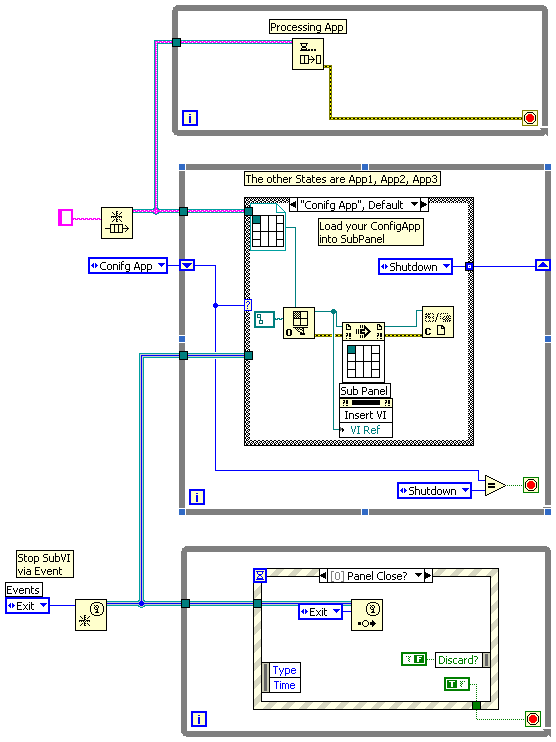

Sounds reasonable. In the LabVIEW style book by Blume there is an example of using subpanels with vi server (if I remember correctly).
You could place the Config App, App1, ... inside a state machine. This will be nice if you need to change/insert anything on that sequence (lika an abort functionality).
If your processing App might be slow, it is also reasonable to use the producer/consumer design pattern.
I think some pitfalls are in the event handling of the main window. You would need one more loop to catch events like the Panel Close? or an global Exit. Then you need to pass this event to any of the 4 Apps that might be running in the SubPanel. I would advice to use User Events for this, as the apps already have an Event Structure.
If you go OOP, there is some more concepts you might use...
Felix

Thanks guys.
I'm thinking SubPanels with Producer/Consumer structure.
I can't picture how a state machine might work.  Example?
Object orientated design I know nothing about..  How to learn more?

To clarify some of my ideas, here a fast scetch:
Sorry, CCT didn't work to make a snippet.
Felix

The application consists of 5 separate projects (100+ VIs each), each with a single main VI.
I am interested in the use of these "functional globals" but have never used them.  How can I learn more?
I also want to dynamically call VIs.  I believe I know how to do this but not sure how to best fit it into the overall structure.
Thanks for posting the screenshots.
