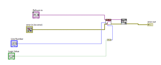

Hey!
I cannot send you the VI, but here's a picture of the same:
Basically, there's only 1 port with 8 lines (0 - 7) on the NI 8451, so keep the port number unconnected and set the line number to what you want.

Refer to the image in my previous post. For writing values, you need to set the Logic Value control to FALSE, I guess. Try changing it from 0/1 and see what happens. Best thing is to refer to NI 8451 user manual.
Message 17 of 18
(1,530 Views)
Just saw your image. Why have you put the writing part inside an infinite while loop?
Your while loop will never stop if you've set FALSE as a stopping condition. I'd say remove the while loop.
And as I said before, try changing the value of the boolean. Also, these are the properties I set in my NI-845x device configuration:
Try using these.
