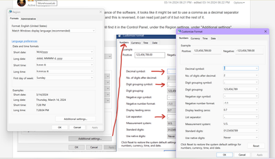

Something else I just noticed is that based on the appearance of the software, it looks like it might be set to use a comma as a decimal separator instead of a period.  If it's set to read from a file or device and this is reversed, it can read just part of it but not the rest of it.
Can you check the settings of all the PCs for this?  You will find it in the Control Panel, under the Region settings, under "Additional settings".
If the two working PCs are set one way and the nonworking one is set to another, that's probably it.

Just checked on both computers and they look the same 😞

Check date format also, that's a common issue.
You know what the similarity between Excel and a stalker is? Both makes the wrong assumption of what's a date! 😄

OMGGGGG IT IS WORKING
That joke about excel solved a 3-month long issue...
I use on my computer day-month-year, when I changed to month-day-year it worked! I can't believe it was something so DUMB
