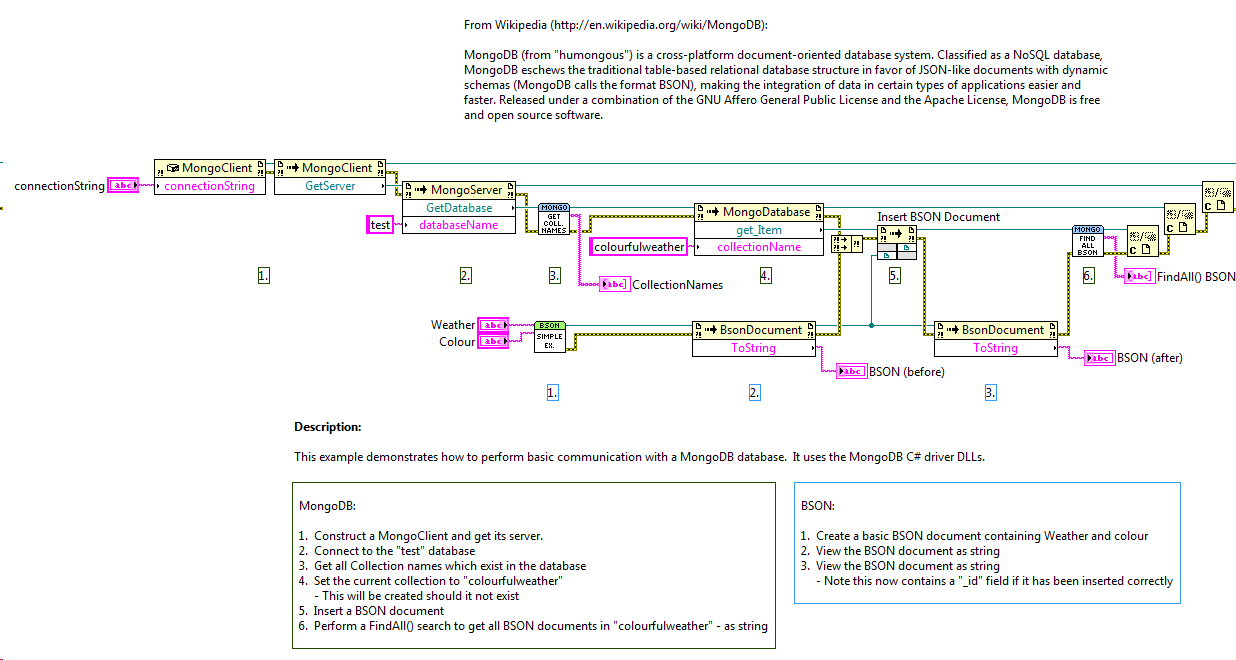

8 months later.. I had the same question and ended up on this post.
There is a C# driver which contains two DLLs which can be used to perform communication with the database.  I have a basic example working which:
  1. Connects to a "test" database
  2. Gets all Collection Names
  3. Opens/creates a collection and inserts a BSON document
  4. Reads back the BSON document
Hopefully this is of use to someone Smiley Happy
Peter D

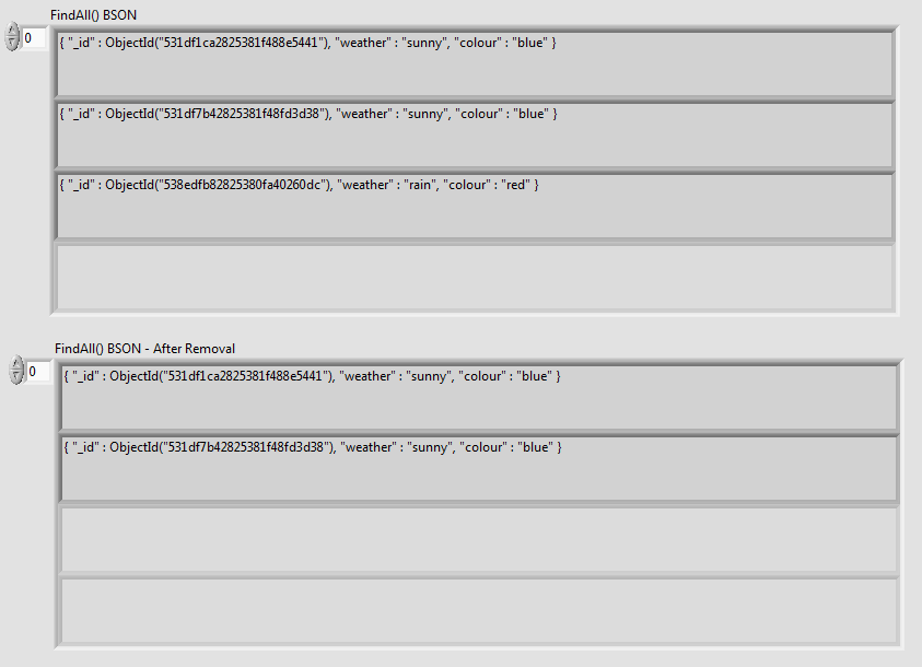

I also like to use some other functionality but unable to find the IMongoQuery constructor and its method. Could you please also provide an example to remove a record, like {Weather: rain; Colour: red}?

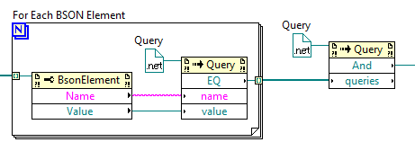

For queries it shows the following code:
var query = Query<Entity>.EQ(e => e.Id, id);
So I went looking for Query, which exists (MongoDB.Driver.Builders.Query) - but with no public constructor.  For fun, I tried placing a reference to this class and using an invoke node - this lists all the comparison types supported by MongoDB - some of which return a MongoDB.Driver.IMongoQuery.
I've setup a "AND" query which takes an argument of an array of 'queries' - I've then modified the BSON document code to also return an array of it's BSON elements - you can then create a EQ query for each element and wire them through to the AND query builder.  Probably not optimal but hey, it works Smiley Wink
