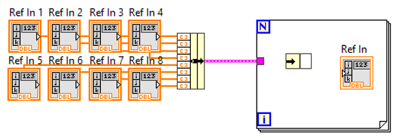

I have a multichannel system (meaning one measuring system with one, lets say, a power supply, a switch, many resistors, and one multimeter).
I want to make all the channels sequencial measurements with the switch going by all channels (assume 8).
Instead of having a work area of the 8 channels repeating the same thing, I want to bundle stuff (parameters, some reference measurement for some later calculation), and select them to send to a single channel measuring step.
In the picture I am showing the channels (in this example 8), and for the DUT name, an array with the string names. I could select the name of the sample with the Index Array if I place it on the for loop (same for other 1 dimensional parameters).
But assume now that I want to measure an V-I curve for a reference resistor (to normalize measurements or correct for different switching channels). I will be taking a set of values that I will be using to normalize the data. That is I have a vector of n points length.
How I do the same thing for the nx1 arrays that I want to bundle and then selectc?

Bundle each array into its own cluster.  Then Build an Array of those clusters.

Build the ref arrays into a 2D array and autoindex at the loop boundary. You get one 1D array per iteration.
I assume the string array also has 8 elements.
Autoindexing will loop until it runs out of elements, no need to wire N at all.
There is no A/D converter with so many bits that you require EXT. That just slows you down.
