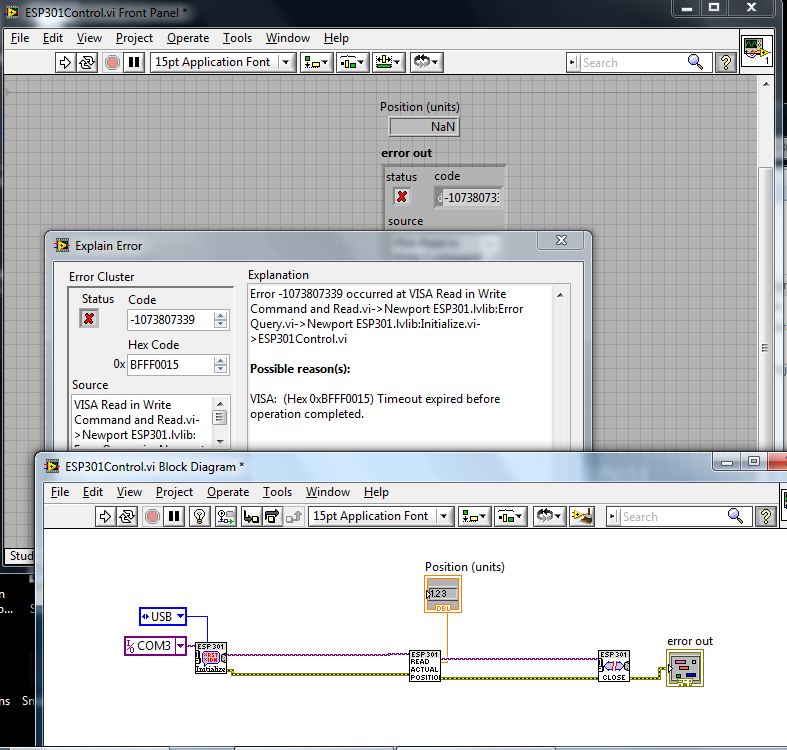

When I was trying to read the position of the stage by using the following program, there was an error saying something wrong in the Write Command and Read. Do you know what is going on here? Thanks!
Message 12 of 30
(4,262 Views)
Without hardware, can't be sure, but looks like maybe the Write Command and Read (sub)VI is not sending a properly formed command. Usually this involves the wrong or missing termination characters.
Double click down a few layers on Initialize.vi (follow the error call stack) and see where the termination character is added, then check it matches the documentation available for the ESP301.

Hi  cbutcher,
We are using RS232 instead of USB cable now, and labview program can control ESP301 now. Thanks!
