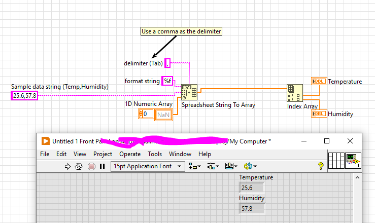

First let's talk about parsing your serial data. Instead of sending the temperature and humidity as two different things send them together in one string separated by a comma.
Instead of: Serial.println(leituraTemperatura); and  Serial.println(leituraHumidade);
Use this: Serial.println(leituraTemperatura","leituraHumidade);
That will send the temperature and humidity separated by a comma.
Then in your LabVIEW use Spreadsheet String To Array and Index Array to parse the string like the example below.
As for your serial communications you should watch this video:  VIWeek 2020/Proper way to communicate over serial
VISA Serial defaults to Termination Character enabled and Serial.println() sends a a newline character (ASCII 10, or '\n') at the end of every line sent.
