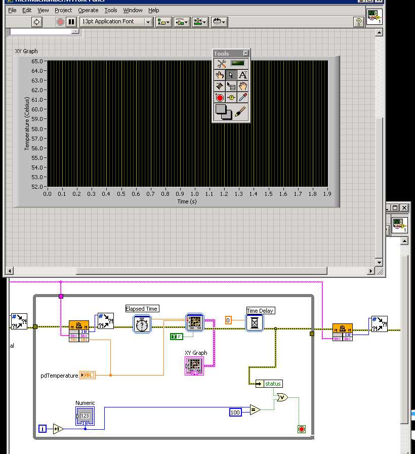

I'm encountering a weird glitch which occurs any time the Labview vi Window is moved around (click/drag) at run time. It appears as if Labview is processing the the window events and holds a lock on a resource required for one of my external dlls. This particular dll is a c++ library with C exported functions. The dll goes through a COM layer. The first call fails and returns the error 0x8001010D, "An outgoing call cannot be made since the application is dispatching an input-synchronous call.” The link above is what I believe may be occuring, but i dont know what the work around would be. These same calls having always worked fine from a cvi c .exectuable or .uir. Below is a sample, the error occurs frequently, while inside a loop while-loop, where i'm querying the instrument continously.

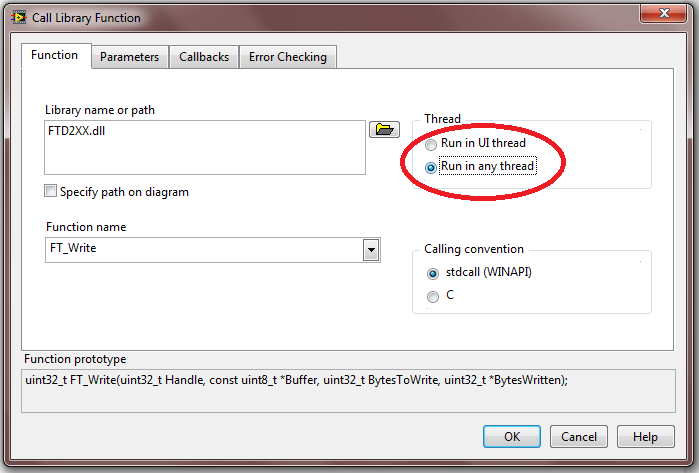

I have one suggesion, you dlls are set to be callled from the UI thread, change it so that it can be called from any thread (see image). Maybe it will help.

I've tried the "Run in any Thread" before and it actually makes the .dll calls fail completely. It only works in Run in UI Thread.

  • Make outgoing COM calls on another thread.
I tried the "Run in any Thread "option in Labview this does not resolve the issue

I just want to add something about running in another thread. I'm reasonably assuming that the fact that you set it to run in another thread doesn't actually make it run in another thread. You have it in a single loop, so I don't think LabVIEW would run it in another thread.
If you want to be sure that it's running in another thread place the dll calls in a second loop and communicate between the loops with a queue. This will probably create two threads for the two loops. And a queue, I believe, doesn't copy data so it wouldn't be less efficient.
