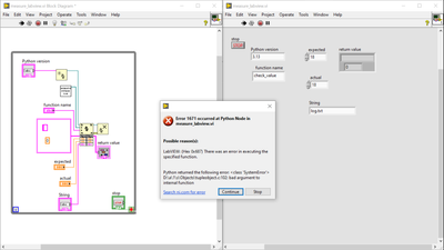

I added code to be able to log every time it runs. When using LabVIEW, an error occurs; can you please take a look to help me?

Well, your python function returns a list... Which I don't think you want, since error_code is a number and result a string (shouldn't this be a boolean?)
Remove the [ ] from the return line. Then make sure that the order of you LabVIEW cluster is the same as your python tuple.
Message 7 of 11
(2,916 Views)
Looks like your python code returns number, string and the LabVIEW code expects string, number. Order needs to match.

Thanks for the help, I got it running. But only when running python log appears. What do I need to install for labview to be able to have log when changing reference values

The file is probably being created just not where you expect. Because you didn't specify a full path python is treating "log.txt" as a path relative to the working directory. Try an absolute path like "c:/log.txt" assuming Windows. Don't forget to escape the /, put "c://log.txt"
No idea where the working directory is in a python node...
