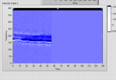

I'm part of a group that's currently working on pump-probe spectroscopy, and for that end we're using LabVIEW to collect data from a Lock-in Amplifier, which essentially gives us a 1D Array of Double values, which we collect as the 'y' values.
Our issue currently is that these values should be connected with time positions; we're using another piece of equipment, a Smaract stage, that moves in increments of microns, which we have converted to picoseconds to get the time. We take 130 data points for this general lab, with the collected data averaged within that loop 384 times, to go over our entire spectral range. Our problem is that the Intensity Graph, labeled 'Intensity Graph 2', is displaying our values incorrectly. I'm not sure exactly how, but my assumption is that the indexing only allows the values to be displayed through half of the data, and it seems that it is assuming our 'x' data is the time domain we want to get in terms of picoseconds. I'll attach images below from the block diagram, to help visualize.
Essentially, we want our 'x' values on the Intensity graph to consist of the 'Time Points' double data, while we want our 'y' values to be the values obtained from the DAQmx acquisition loop, averaged over a set of 384 and then displayed there, while the 'z' values in the amplitude should be the variation of that y-data. Is there something wrong with our indexing? Or are we putting data in the incorrect places? For reference, we obtain and collect our Time Points in Case 0 of our structure, as shown below:

As I mentioned, I'm not as experienced in LabVIEW, I have focused on workable code rather than a holistically foolproof approach. That is true that the problem is likely not version specific, apologies on that end. I'm unsure what specifically is needed for simulated data, but I am attaching the VI along with our most recent set of half-complete data, hopefully that should allow for viewing of the program.
For our results, we currently view a graph of the form below:
 This has an x-axis of the data points specifically, while the y-axis refers to the number of times we run through the averaged y-data. We'd like to have an intensity graph where the x-axis reflects the time points we are shifting to (in order of -1 ps to 3 ps over 130 steps) while the y-axis bars will display the averaged y-data in a form akin to the graph below, with the trend then continuing for each subsequent time position we shift to.

An intensity graph is a 2D array with of course integer indices in both dimensions. Both axes are equally spaced and the translations to real units is set by x0 and dx of the axes that you can calculate based on your linear x and y ramps.
Currently you are replacing each row twice with different data, which makes of course no sense at all.

So what do you suggest is the fix? I assume you are referring to the Replace Array sub.vi that formulates the data for the intensity graph, do you believe this will be fixed through adjusted one index to head into columns?
As a note, I am aware that the indices are not entirely proper, I have been given the program to work on. One of the indices, as its data has 384 entry points as opposed to 130, I assume needs to be looped aside from the major for loop around the lab creating code, which I plan to try and fix in the future.

Here's a very quick attempt at some code cleanup. I don't have any of your hardware or subVIs, so I simulate data instead. See if it can give you some ideas. It is a "literal" cleanup with some glaring redundancies corrected. I am sure there are many places to improve up. Notice the difference in diagram size!
(NOTE: No sequences, not local variables, and no hidden controls/indicators to hold data.)
(And yes, get rid of these units and do explicit conversions. For example x0,dx don't understand units. Not shown here, but look at the disable structure on top)
