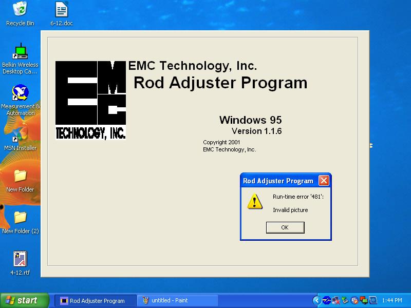

Hello all! I'm having issues opening LabView on device:
1. Message: Run-time error '481', Invalid Picture
2. Message: DAQ ERROR!!!, DAQ Error - 10005 Occurred. Do you want to continue?. If I click YES system close program, if I clock No, system close program too.
This is a criticla application in EMC Tecnologia Operations, I appreciate all help you can give us.

Nothing indicates that this program is even written in LabVIEW.
  • What does the program do? Who wrote it? Where did you get it?
  • Did it ever work on that computer? If so, what changed?
  • What happens if you just open plain LabVIEW?
  • What LabVIEW version are you running (probably old, since you are running windows XP)
  • What drivers are installed?
  • What is the "device" you mentioned (...opening LabVIEW on device....).
(4,963 Views)
Error -10005 (found by looking at explain error in LabVIEW) stands for Device is invalid.
That means the program is looking for a DAQ device that either doesn't exist on the system, or perhaps exists under a different name than what the program is trying to call.
You need to contact the programmer for this program for their help.  There is nothing we can do on the forums for you.

Yeah, since the program was written for Windows 95 by the looks of it, you might also want to think about getting the program upgraded to work with software/hardware that isn't 15-20 years old!

Presumably there is some documentation with the program which should tell you how the hardware should be connected. Following those instructions should fix the DAQ error.

Hello all! Thanks for your comments and suggestions, effectively local provider has fixed issue in local program.
Regards!
