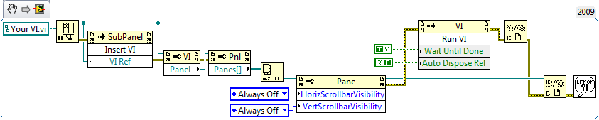

You can change the option of scrollbar visibility in the property nodes.  Attached is a snippet that shows how to do this.
