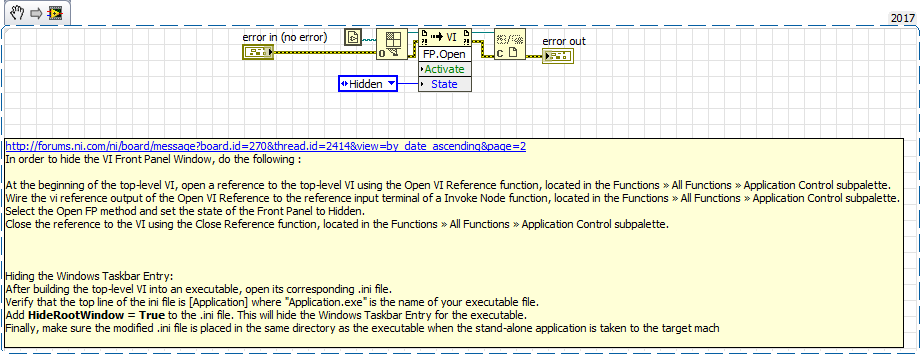

Here is a VI I made to run LabVIEW programs hidden, it contains some notes I gleaned from this forum.
Maybe it's because you are setting " transparency at 100%" instead of using the FP.Open State property.

I reboot my computer this week end and this morning it is working without reason because I didn't change anything. Weird. I keep the topic open because your solution is very interesting. In my VI I set to False the FP.minimizable parameter of the VI.
