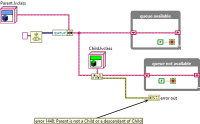

You haven't provided any code so all I can do is take a few stabs in the dark based on mistakes I have seen in the past:
  1. LabVIEW object wires are by value, not by reference
  2. When you cast one class to another using "to more specific class" or "preserve runtime class," if the node errors the output value will be the default for the wire:
