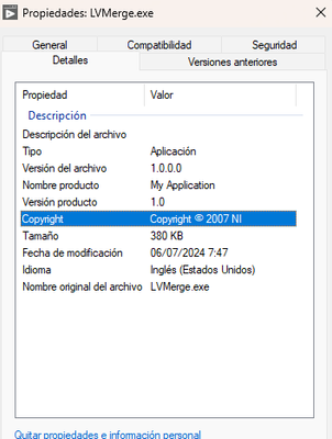

I cannot see the LabVIEW version used to build the executable in the properties of the .exe file. Only information I see is:
Thank you,

Hmm, the version is weird, when I look at LVMerge in my LV 2015 folder, it shows me the following
Message 6 of 16
(1,990 Views)
I can confirm that for version upto 2021, the version of LVMerge matches the LabVIEW version.
On 2023 Q3 and 2024 Q3 the LVMerge version is 1.0.0 as OP has shown.
