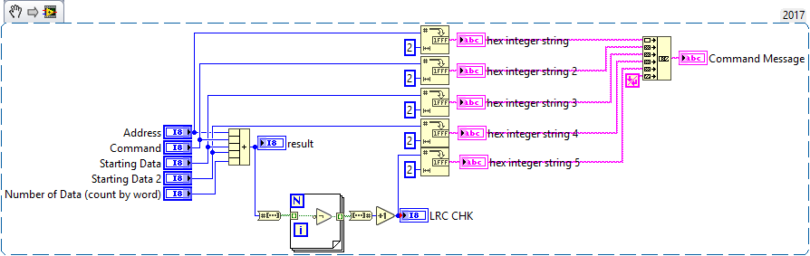

I am trying to get and set temperature using this device using LabVIEW. I am able to communicate with the controller and it is responding to my write message. But when I try to say set a temperature of 28C, it sets it as 2.8C instead. Write command used is ":02064701001C94" to set 28C. Can anyone please tell me what am doing wrong? (code & manual (pg 17 attached)

Try to send the command:
02064701011894
If this works then it would be because the controller is set to use one decimal. You need to send it a value that you can add a decimal to. It should be that easy. If you change the decimal setting in the controller it would change what you need to send the controller. This is what I have seen in the past.
I don't have that controller to prove what I believe is going on. To make your program flexible you will need to read out the decimal position and send the commands using that info.

You commanded 2.8 C and got 2.8 C. The units (p.16) say .1C Multiply your hex number by 10. . . .

OK here is a vi that will calculate the command to the device. I would try to read 2 words and three words. This might be what the problem is. You are only reading two words at the moment. I would try to read three and see what we see.
I realize there is an easier way to do this I just wanted you to see what I did to get to this value. It matches the document that you attached as reference.
Tim

OK I made a command generator using a ring. You can set the values and it will generate a command for each parameter. I also added an interpret vi. I don't have enough data to know if what I am doing is correct.
I would try to read the PV with one word.then 2 then three. This way we can try to see what the system is really sending since what you set me does not match to what they tell us to expect.
