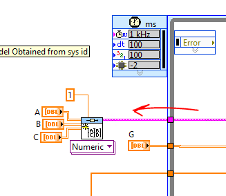

Hey Barp,
I think I am facing a similar challenge. Trying to implement an LQG controller as attached in the following VI.
I am getting an error,
      NI_CD_Stochastic Systems.lvlib:cd_verify m Q R N.vi<append>
<b>Complete call chain:</b>
NI_CD_Stochastic Systems.lvlib:CD Verify Noise Model.vi
NI_CD_State Feedback Control.lvlib:cd_Kalman Gain (Stochastic).vi
Will appreciate your help!
Message 11 of 26
(2,577 Views)
When I change the Kalman Gain VI to a discrete kalman filter as in the image below
the code runs fine on the RIO target but neither the observer gain nor Kalman filter gain are computed. The VI is attached below,
When I double blick the discrete KF vi, I see the following in the error display:
NI_CD_Stochastic Systems.lvlib:CD Construct Noise Model (Numeric).vi
Soft_Robot Model Two States.vi
Wondering what I could possibly be doing wrong.
Will defo appreciate your help.

Some things to consider:
a. The A,B,C,D matrix on your file was not saved. You have to enter and make current values default to make it fixed.
b. To have a better speed, you should try to create the State-Space Function and the controller 'outside' the loop, since it seemed that the controller is not updating...
c. Your implementation of the state feedback control seemed to be misleading... you should use the function y = -Kx and then, only the
d. To know which size of variable to use (E{v}, E{w}, Q, R, N, etc), you can try to open the "Discrete Kalman Filter" , Select Stochastic SS, and then, use the dimensions to tell you want the parameters are suppose to be (The UI has a way to define those features).
e. The QRN for LQR is different then the QRN for Kalman. Yes, it is confusing, but they are different sizes and it is pretty easy to be confused.
Anyway, this is just to allow you to make this to get the right size.
I hope this helps a bit...

Here are some responses:
a. You type the numbers in the matrix, then you right click to it, go to "Data Operations" and select "make current value default". Notice that you have to right click at the border of the matrix, and not in the middle. OR, the easiest way would be to fill all of the controls and indicators properly and the go to Edit menu and select "Make Current Values Default". Then, to be sure you have the values, close the VI and open again. If you did not do the procedure correctly, the matrices will be empty.
b. Well, the matrices are outside, however, in dataflow, the 'creation' of the state-space model is done inside the loop. So, the procedure to 'create' the state-space model is repeated over and over, although you would not change the values. Here is an example of what I meant below. However, if for some reason you need to change the values while the loop is running, then the matrices and the creation would have to be inside the loop....
c. the function is located at: Control & Simulation >> Control Design >> Implementation folder.
d. that seemed reasonable, but you have to be careful with somethings. First the size of the noise. This is defines the size of G and H. If those matrices are empty, then you will have an error:
Then, when defining the noise model statistics, notice also that you have to specify the dimensions based on the noise size. Here is the size that should be entered for a noise of size 1. Notice that, although E{w} and E{v} are zero, then need to have 'dimension of 1' as zero to avoid generating errors.
So, the size of those matrices are based on the noise size and the output signal, and not on the states or inputs.
Again, the QNR for Kalman is different than the QNR size for LQR. We probably should have call those variables differently.

The error I've got (I had to remove your FPGA code) was the 'covariance matrix' size. The P(k|k-1) has to be 'squared' and positive definite. The value hard coded on the Kalman Filter was not squared. As soon as I made it a square matrix, then there was no error anymore.
Please also see this example below:
C:\Program Files (x86)\National Instruments\LabVIEW 2015\examples\Control and Simulation\Algorithms\Kalman Filter\1D Kalman Filter Encoder and Accelerometer.vi
In here, this shows a 'framework' where you can have a 'simulation' of the plant you are trying to control and the separate loop to define the estimation (and you can add control). This could help you to better tune your controller too.
Barp - Control, Simulation, RTT and HIL - National Instruments
