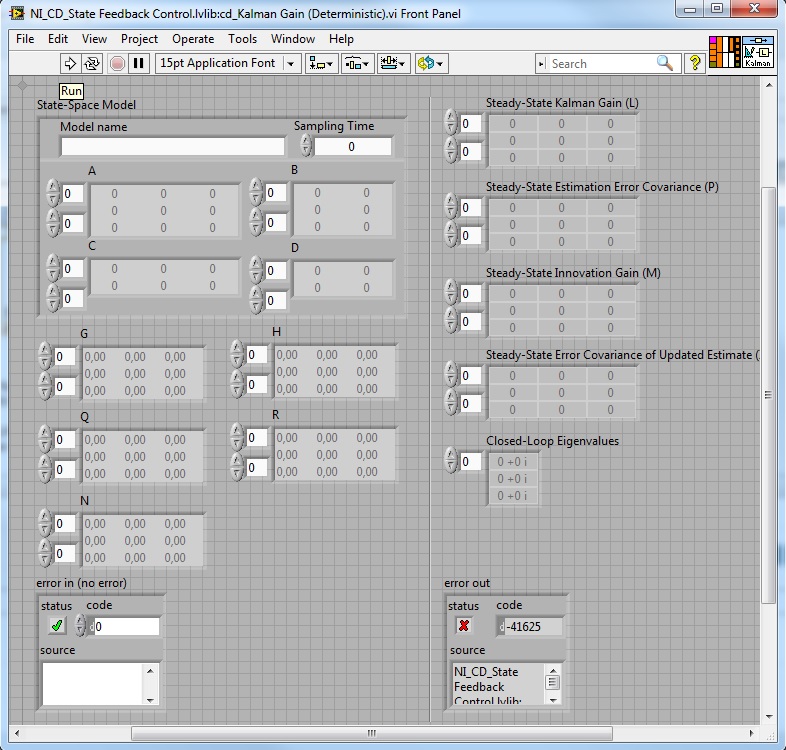

But i am still not sure if it works well because the "Kalman Gain.vi"does not run on its own. There are no matrices shown and
"NI_CD_State Feedback Control.lvlib:cd_Verify Q R N G H.vi<append>
<b>Complete call chain:</b>
     NI_CD_State Feedback Control.lvlib:cd_Kalman Gain (Deterministic).vi"
is shown as error out.

I have tried to set the size of Q to 1x1, but an error occurred. (Error -41651 occurred at NI_CD_Stochastic Systems.lvlib:cd_verify m Q R N.vi). Because of this, i changed the size to 78x1. Now the VI runs as a whole but the single "Kalman Gain.VI" shows an error.
I am using Labview 2013 Service Pack 1, Version 13.0.1f2 (32-bit)

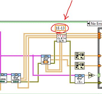

So, I was able to modify your code to make it work: here are the changes:
a. Q matrix incorrect size: The Create Matrix, when you try to use in "diagonal" mode, it will not use the "matrix size" to define the size of the output matrix, but the dimension of you vector. In your case, you had the dimension of 78 on the vector. I just made it 1 for your application.
b. G matrix incorrect size: in your model you have 78 states and 1 'noise' to the states. So, you should have created a column matrix with ones.
With those two changes, you will be able to get the function running, BUT it will generate the following error:
Error -41626 occurred at NI_CD_State Feedback Control.lvlib:cd_Verify Q R N G H.vi
Possible reason(s):
Control Design and Simulation: Nbar is not valid because the matrix [Qbar - Nbar.inv(Rbar).Nbar'] is not positive semi-definite.
Which means that the computation of this gain will not be stable. If you really want to produce a result, you can try to temporarily change this value on the "Kalman Gain (Deterministic).vi" to 1E-8 and this should provide you a result. However, you will notice that the conditioning of this results are not good.
Now, on the other hand, if you think you do not have noise signal applied to the states, then you can make the matrices G and Q 'empty', which indicates that you have only noise on the output, and then you will be able to obtain gains for your system.
In attachment you have your VI modified with both behaviors.
