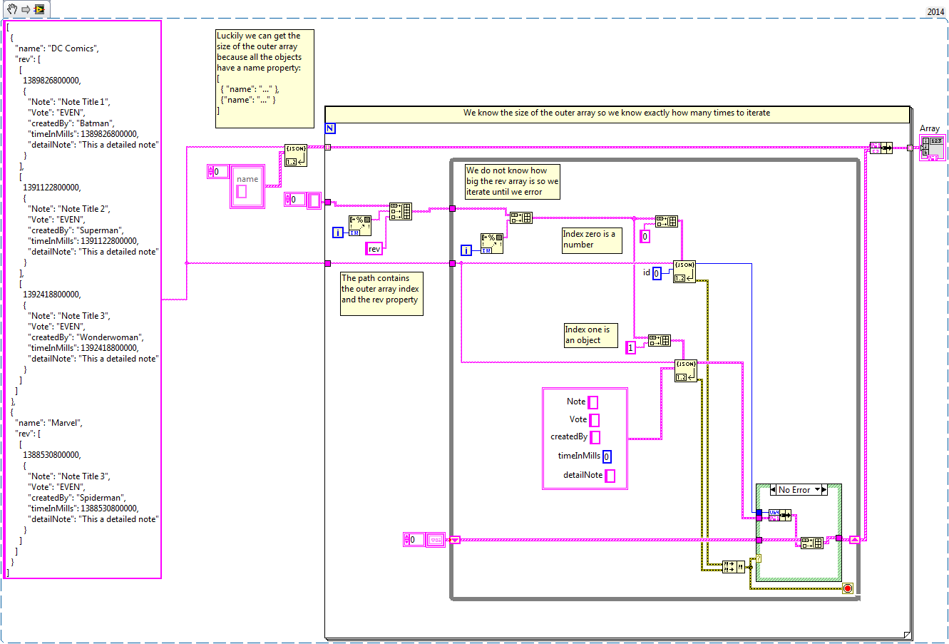

Hey Golzio,
The problem here is that the Unflatten from JSON primitive only makes it easy to parse JSON data that be well represented by LabVIEW's types. So cases like this where we have an array with mixed types are more difficult.
It is possible to parse JSON Arrays with mixed types using LabVIEW's primitives. This is done by using the path input on Unflatten from JSON to navigate into the JSON data and extract the values you need.
The following example shows how you can create paths to extract the data from your data set:
From that example you can see how we build the path array in loops and use Unflatten From JSON to extract values one-by-one. A problem with this approach is that we are calling the Unflatten from JSON many times inside a loop so this might not scale well for large data sets with thousands of items. The benefit is not requiring external dependencies.
I'm glad the i3 JSON toolkit worked for you (full disclosure I developed that specific toolkit) and it's good to know that there are other options are available such as the newer JKI JSON Toolkit and the existing LAVA JSON LabVIEW Toolkit
Milan

Hi Milan,
thank you very much for your time.
It was very useful to understand better and in deep the smart use of "path" input of "Unflatten form JSON".

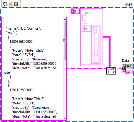

I've just released a new library called JSONtext.  Part of the reason for a new library is to provide more complete support of JSON, including mixed-type arrays.  Here is a solution to the above problem, using JSONtext:
 In JSONtext, mixed-type JSON arrays can be unflattened to clusters of unnamed elements.
