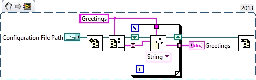

Something like NI_LVConfig.lvlib:Read Key.vi. The following gives me the same output as cases #3 and #5 in my original post:
[Greetings]
English="Hello"
Chinese="你好"
It's ironic that the "non UTF-8 aware" INI VI preserves my UTF-8 input, while the "UTF-8 aware" JSON function mangles it. 😛
