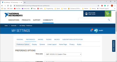

Take a look at the image below, start with your user name in the upper right.

Yeah I don't have that option

I see that you are a New Member, just registered today.  It is possible that new memories don't have full access to everything.  It can help prevent things like spamming.
Give it a day or two when you are just listed as "Member", and see if the option will show up then.  Maybe it takes more time or messages on the forum than that.  If you don't see the ability in a day or two, do a Notify Moderator on the message thread and ask about it.
I know one thing that sometimes happens is someone new will go and harass a number of members through private messaging begging for help directly.  But I haven't seen that happen in a while.  So maybe the messaging feature was turned off for New Members because of that problem.
