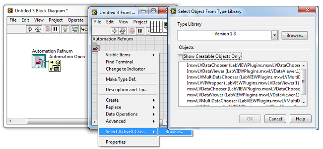

So if I understand correctly, you're doing something like this:
(2,779 Views)
Hello Chad,
So if I understand correctly, you're doing something like this?
If so could you rename and move PAK.Application to a different location with similar results? Is there another type library you could look in? Also what happens when you try PAK?
