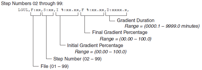

I'm trying to write a simple-ish VI to automate the programming of Teledyne Isco syringe pumps (the user inputs a function, time duration and number of steps and the program generates the pressure/flow values and uploads them automatically)
That part is simple enough, just some basic maths and a 1-D array, however when I format the requisite string to send to the pump, it returns the error: "R018PROBLEM=INVALID OPERAND 77"
I'm pretty sure this is a formatting issue, otherwise I'm fairly sure I'd be getting invalid command rather than operand, and sending other strings like G& and LOCAL result in the correct response from the pump, I can manually set pressures, run and stop the pump etc, so the connection is just fine.
the test string I'm trying to send is: “LGUL,F:01,S:01,I:05000,F:05155,D:0001.0,”
According to the manual for the pump, that is the correct formatting, but there is little guidance on resolving the problem code

Page 8-34 on that manual says:
The operand (character(s) following the = sign) is missing or is incorrect; e.g. , the number was too large
Is there a chance you left out a decimal point on the F value because 5000 seems like it could be too large of a number.
Sholyoake, are you absolutely sure the parameters are OK. It looks like the valid range for "I" and "F" are from 00.00 to 100.0 (page 8-31). As RavensFan wrote, check your values
Message 8 of 11
(4,941 Views)
Oops! Should have looked a few pages farther in then manual. Here is the syntax and your values look in range.
 EDIT: Actually the Initial pressure minimum is 00010 and you use 00000. Could this be the problem?
Message 9 of 11
(4,938 Views)
yes, I'm using the string formatting from figure 8-11 rather than 8-9 as posted
I think I've had a breakthrough, it seems the D value prefers to be 4 figures rather than 5....
