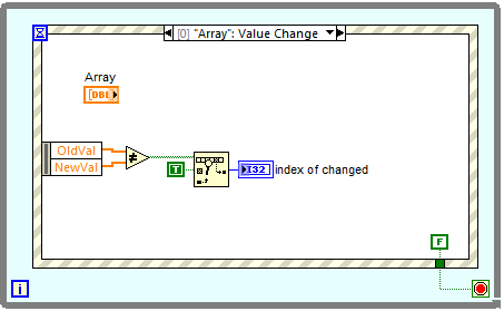

There is no easy way to tell if the Increment/Decrement arraws have been clicked on. You can check to see if the array has changed using an event structure.
The problem with an array of numerics is that you get one event when any element of the array is changed. See the code picture here for how to check which element was changed.
Rob
p.s. I uploaded this as a .png since a code snippet left the events of the structure blank (no event name) and broke all the wires from the terminals. But this one is simple enough anyway.

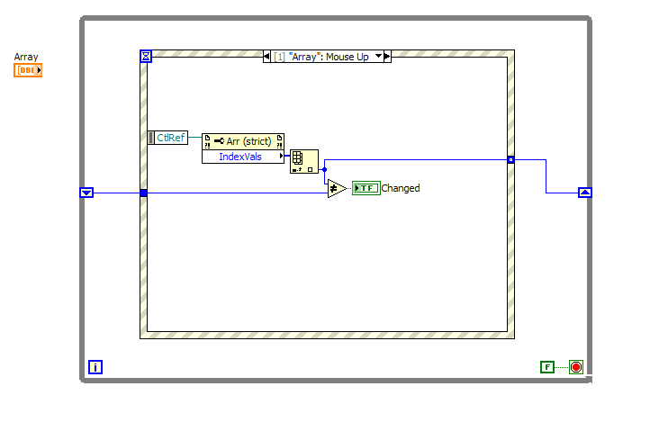

Actually I think you are going to have to do this instead. The example above will only show you when the array value has changed not the index number.
Tim

I thought from the description that the OP wants to know when one of the numeric controls within the array has been changed. My VI will do that.
If, as aestet postulates, he wants to know that the user has changed which index is at the top of the array control, aestet's VI will do that.
I guess this comes down to an interpretation of which up/down arrows the OP is looking for.
Rob
