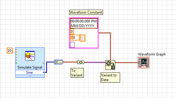

You can either use the Numeric datatype or the variant datatype to write the waveform data.
If you want to write as a numeric datatype, you need to read absolute times stamps and then create pairs to write to the database. You can find an example at : \\labview\examples\lvdsc\Database\Direct Writing
If you use the variant datatype, you need to use the To variant function to convert the waveform into a variant in order to write to the database. If you need to read the data back into labview, convert the variant back into the waveform datatype by using the Variant to Data function and use the waveform constant as the type as shown in the screenshot below.

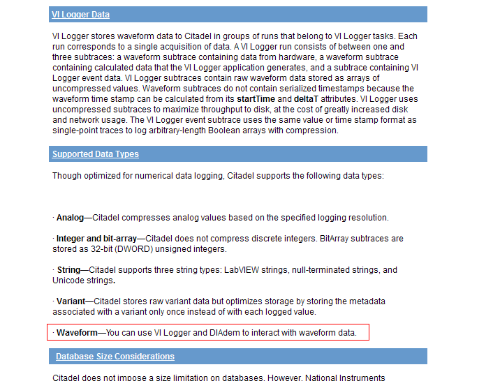

The techniques you describe do not constitute a waveform datatype which is what is mentioned in NI documentation. A native waveform datatype should allow traces to be viewed in MAX or the DSM Hypertrend.
(4,462 Views)
It think this statement is misleading, since it implies that Citadel actually does have a native waveform datatype,
only LabVIEW does not support it.
http://zone.ni.com/devzone/cda/tut/p/id/6579
Citadel Data Types
