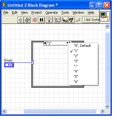

It seems that a "-" works once in an enumerated value too. Would it be usefule to other people to be able to have more than one in this type of control? I could see the use of it for orginization of states for a state machine, events or type defs.
Tim
GHSP
(4,599 Views)
I'ld be careful.  It is imposible to select enum - (seperator) but it HAS a value and IMHO it obfuscates code.  very limited potential to order a state machines states.
