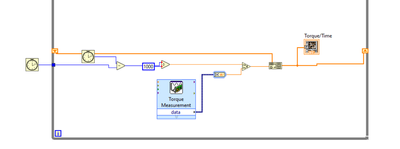

Im trying to build my xy graph and want the Date and Time as X axis. I now got the Time in Seconds after starting.
Any hints?

Hi Juls,
format the x axis to show relative time.
I recommend to use the HighResTime instead of MillisecondTime as it outputs relative time in seconds instead of milliseconds.

Arrrggghhh!  A picture of an Express VI that I can't find on my Palettes!  I can't tell whether you've got a Graph or a Chart, can't see its appearance, have to "guess".
