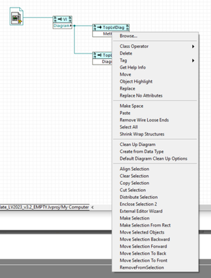

How can I acces to internal/Private Propertys?
Message 1 of 15
(2,390 Views)
To be able to view private classes/methods/properties, add key "SuperSecretPrivateSpecialStuff=True" to your LabVIEW.ini and restart LabVIEW.
More infos: https://forums.ni.com/t5/LabVIEW/How-do-I-enable-the-following-private-functions-in-labview-2014/td-...
Then for deprecated ones, you will need to configure your invoke/property nodes via scripting:
Raphaël.

Try putting SuperSecretPrivateSpecialStuff=TRUE in your LabVIEW.ini file.
