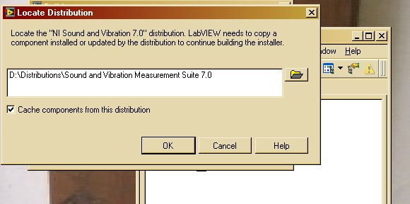

But lo! NI say i need Sound and Vibration Distribution, now where did that come from? My vi doesn't have sound and vibrations functions...
I click no, Labview don't build the installer.
I click yes, Labview kept on asking me where is the Sound and vibration library.
I bought a NI Developer suite, that expensive stuff costing around US$4000+. My software vendor told me I dont have the license for Sound and Vibration Distribution.
So what should I do? Did I click some wrong settings during installer build? Is there someway to bypass this problem? Advance thanks!

To clarify all this - please understand that the prompt for the "Sound and Vibration" distribution IS NOT A BUG! This is by design, and don't worry - you're not pulling in any additional components that you're not intending. It's because NI's software is modular, and  underlying software components are shared across many products (similar to Lego blocks). It's just that, in this case, the best fit of components needed for your installer come from that distribution.  Also, notice that the checkbox for "Cache components for this distribution" is checked -- so you won't be prompted for this distribution in future builds of your project.
As such, you do NOT need to repair DAQmx or edit the "Installer Source Location" field - everything is working correctly, and you are not violating your license agreement.  Besides the above KB, here is a good thread on a similar question:
http://forums.ni.com/ni/board/message?board.id=180&message.id=38917
- WesW / NI
