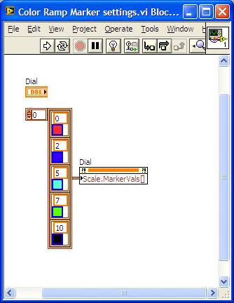

Inserting exact Marks on a Dial when you're using arbitrary spacing
I am currently adding a ramp to my dial so that it gives it color for a RPM gauge.  My question is that you have to use arbitrary spacing to accomplish getting color and I was wondering is there an easier way then guessing and right clicking each position?  Can I instead somehow enter the numbers I want like 1000, 2000, 3000,...?

I think this Property node should work.
Just fill up the cluster array with marker values and colors.

I filled the array from 0-5000 in increments of 200.  For example I did 200 then did a color box and filled it in white as shown by your example.  At the very end for 4000-5000 I added color and then when I tried to run it, it just turned the whole dial white and set the min and max values to 0.  It also didn't show any of the tick marks.

You'll have to set the colors that you want to use for your ramp.
Or maybe I'm misunderstanding what you're trying to do.

I just forgot to set my current defaults was all.  It works great, thanks.
