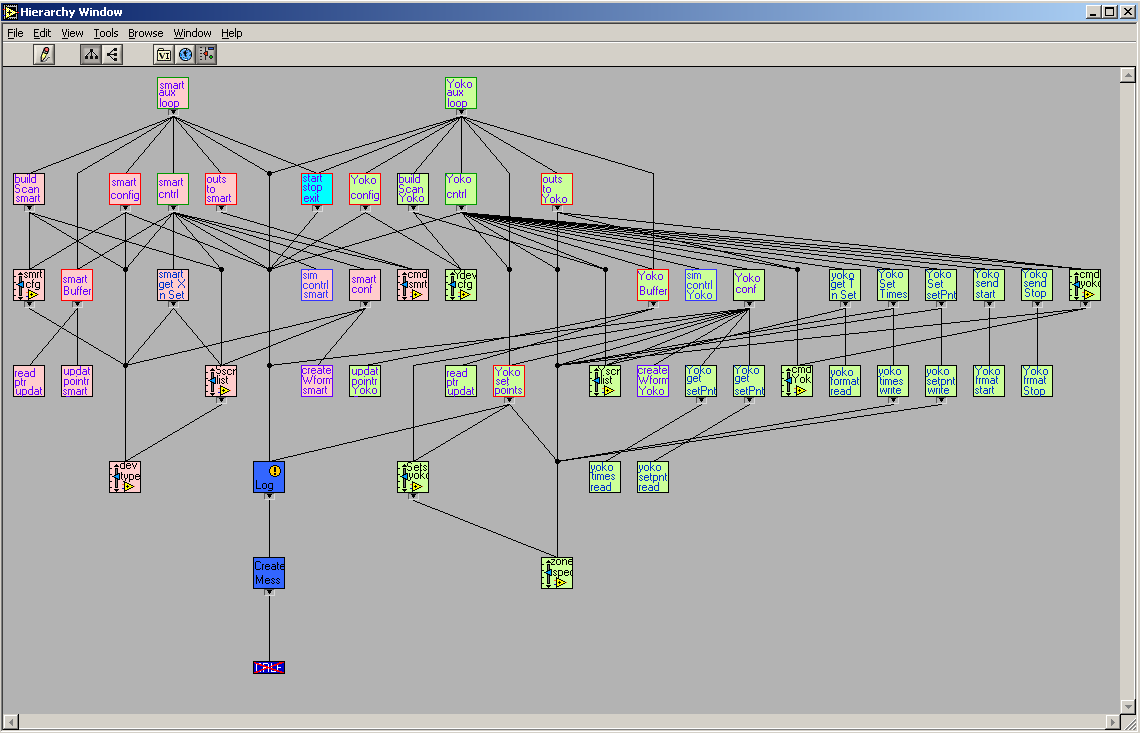

Hi Ben!
   I cannot hide: I was waiting your opinion! Smiley Wink
   I think that MI and Hierarchy are two different tools.  The tell you different aspects.  For example, if you build a top vi, with (below in hierarchy), 1000 VI, you can have a similar MI than if you struct code with a better nesting technique.  Si, in this case, MI tells few.  While, of course, if you have a MI of 1, probably your application is not maintainable!!
   About Hierarcy, I confess that I'm using it more and more, and 3:4 rule is quite interesting, even if I think that a good Hierarchy should resemble a diamond (or rhomb-like).
   Anyway,at this point it will be interesting to take a look at one of your Hierarchy... can you post even a reduced version?

Graziano wrote;
"Anyway,at this point it will be interesting to take a look at one of your Hierarchy... can you post even a reduced version?"
Here is a reduced verions of that LV 6.1 app.
This shows the structure of two of the 6 plug-ins that were used in that app.
I hope this helps,
Ben
