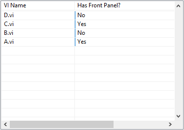

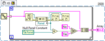

What you are doing works, but if you want something slightly more elegant you can check whether the front panel refnum is valid by comparing it to a default panel ref constant.
See the attached project zip.
A just has one button that calls B.
B just launches C as a modal dialog with one button and a table showing the call chain.
C calls D to populate the call chain table and waits for the button to be pushed.
In the development environment, you should see:
If you execute the build spec and run the exe, you should see:
D.vi.

Hi JimB,
Thank you for the reply.  While I like your proposal and I agree that your solution is more elegant, it is also a tad more complex and will likely take more CPU cycles than what I am doing now.
I can go on to use the FP.CustomTitle return value if the FP is accessible whereas I don't particularly have a use for the panel reference and it needs to be closed once acquired.
Here is a screenshot of what's working for me now (the various error cases include custom error handling). Here I just need to first try a FP access using a property (like CustomTitle) that will test the existence of the FP and if the FP is available, go on to get more properties of the FP. If the FP does not exist then the error is discarded, the VI reference is closed and the data cluster updated to indicate that the VI does not have a FP.
Thank you again!
