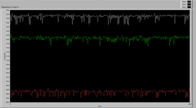

I have a PXIe 6363 that has an encoder on counter 0 and 1.  I have 3 halls of a motor that I want to measure their pulse width (PW) for.  The halls are running to counter 2's, A, B, and Z line.  If I were to create a new PW read task for ctr0 and set the "Input Terminal" to one of counter 2's lines (CTR A or B since the default PW read for CTR2 is Z), would I need to physically disconnect the encoder's signal going to ctr0's gate, or does that happen internally?
Background:
I am writing code for a test stand that uses different hardware for different tests.  I have a PXIe 6363 in my chassis with counters 0 and 1 wired to encoders, counter 2 reading a hall, and counter 3 being a sample clock.  When testing my code, I noticed that my PW (pulse width) read gave me "3 bands of PWs" (I am using the PW to calculate the motor's RPM).  I know my motor is 3 E revs per 1 M rev, so I decimated my data by 3 and plotted all 3 arrays on the same chart.  As I was expecting, each plot was one of the "3 bands of PWs" I was seeing on my raw data.  I believe this is due to the physical variation of the halls (motor's pole pairs) and my plan is to average 60 (I assume that will be enough, 20/"band") PW reads to get my "PW read".  See images below since pictures are worth 1000 words regarding the "bands".
Raw PW Reads - shows 3 bands of calc RPM
Decimated by 3 data - shows each motor pole has its own PW band
When I did my 60 sample average, my RPM was calculated to be ~7160 RPM.  However, when I strobed the UUT, it was ~ 7020 RPM.  Therefore, I figured to get a better estimation for the motors RPM, I could average the average of all 3 halls.  However, CTR 0 and 1 have the ENC wired to them (CTR 3 is being used as a sample clock).  In NI MAX, if I created a "PW read task for CTR0" then set my "Input Terminal" to PFI0 (CTR2 source/A), does the NI card disconnect pin 3 (PFI 9/CTR0 Gate/Z, which is the default pin for a ctr 0 PW read) from counter 0's gate and connected PFI0 to ctr 0's gate?

I took a multimeter in continuity mode and checked arcos pins 3/11 (crt0 gate/PFI0) and pins 41/43 (ctr1 gate/PFI2) without the task started and there was no continuity.  I then started the tasks and checked again - no continuity.  The data I was reading makes sense and matches what I am seeing on ctr2's gate.
Therefore, I think I'm good to say that when connecting the PFI 0/2 to ctr0/1's gate, that the NI card disconnects the default pin (ctr0 = 3 and ctr1 = 41) and connects the desired pin (PFI0/2).

The black circle is the stator, the brown X is the hall sensor, the red circle is the rotor, and the green/purple/blue are pole pairs.  As the rotor is spinning, Brown X is picking up G,B,P pole pairs.  Since there are 3 pole pairs, I should be expecting 3 PW returns.  The "bands" I was seeing in my initial PW read were due to the variation in tolerances of the magnetic pole pairs.
So after sitting down and thinking about it, it makes sense to me that I am seeing "3 bands" since I am picking up "3 unique pole pairs" and any variation in the pole pairs (magnet strength, physical dimensions of the magnets, physical placement of the magnets, etc.) will cause a variation in me reading my PW.  Therefore, if I wanted to anchor myself to a more "stationary point", such as "G -> G" period (or P->P/B->B), then I know that 1 full mechanical revolution has occurred in 3 consecutive period measurements (G -> B -> P -> G).
My new algorithm using the 3 consecutive period measurements and has given more accurate and repeatable speed calculations compared to my old "assumed PW = 180 E deg" calculations.  We got an older strobe and I my speed calculation is within 10 RPM of the strobe.  All of my "G->G/B->B/P->P" are around the same value (using 3 counters to read the period of all 3 halls) and I am seeing "1 speed range" and not "3 speed bands" (like I was for my PW algorithm).  Since "each unique pole pair" for a hall are similar calculated speeds, and, each of the 3 halls are giving similar calculated speeds, I believe the 3 consecutive period measurements = 1 mech rev is, for now based on the info I have, the best way to determine speed for my situation.
